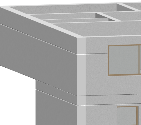

walls in archicad 19 have a weird profile in 3d
walls in archicad 19 have a section in 3d, I am attaching a photo, pls help.

Try turning all Layers on and see if there is an intersecting element with a higher Building Material Intersection Priority in that location.

Tried closing the layer but nothing else. I have a feeling that is something to do with the coordinates. I am attaching another photo. the section is exactly at 2.02 on the z axis.

Based on your first post image, I thought a portion of the lower part of the Wall is missing. In you second post, I now see you are referring to the reveals in the Wall. Are the Walls Basic, Composite or Complex Profile Walls? Only the Complex Profile could have these types of reveals, otherwise they would be caused by some other element acting on them.

Also, make sure the window walls extend all the way to the corner.

Thank you, I've tried everything and still nothing changes. I checked as well my template and it behaves similar. I will finish this project and create a new template. Thanks again to everyone for trying to help.
