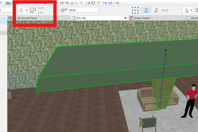

why is the drop panel dimesion locked?
bibiarch
why is the drop panel dimesion locked? I also want to change/add a surface to put a material

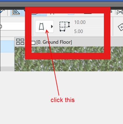

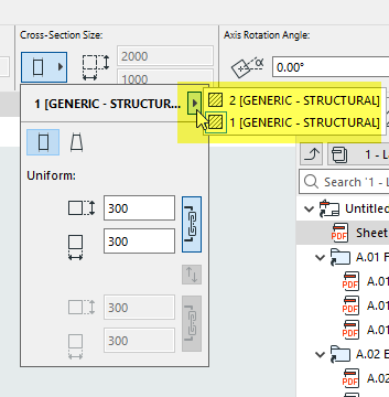

It is a segmented column, so you have to press the 'Cross Section Size' button.
Then you will see a pop-out where you can select the segment that you want to adjust the size of.
