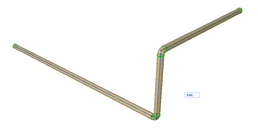

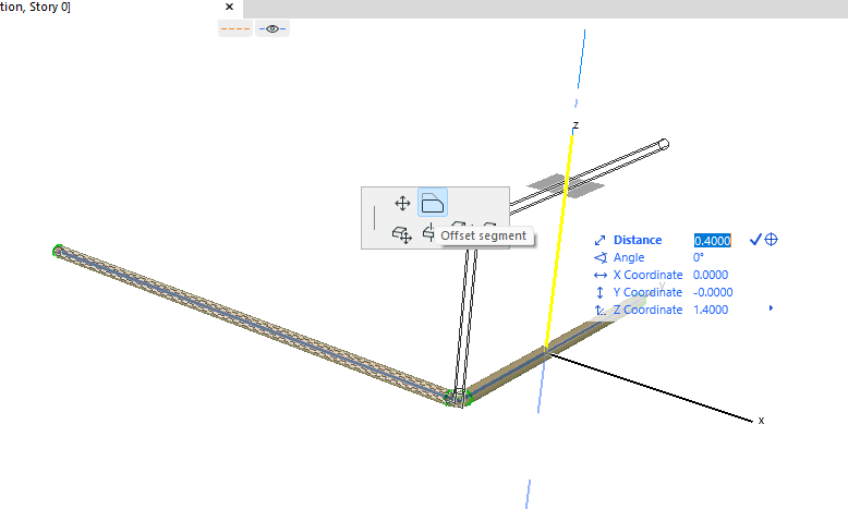

For creating the vertical branch of the pipe or duct route you can draw the whole wrote or a segment of it in floor plan then via 3d view you can offset the segment vertically, see attached Screenshots.
