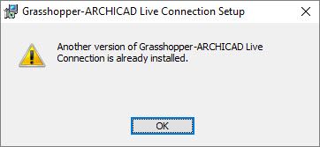

When trying to install the Grasshopper-Archicad live connection for AC21, I get a message telling me it's already installed...but it isn't (see image).
I have it installed for AC20, but nothing for AC21. Does anyone know what the story is here?

I too have this problem even though I have uninstall AC 20

Hey guys,
This is a known limitation of the installer: it sees the ARCHICAD 20 version and clashes with it. You can find out more about it in this ReadMe.
We are working on eliminating this problem for future versions.

Hello Everyone,
I am currently trying to install GH AC21 Live Connections and I am getting the following error.
I have deleted the gh ac connection for 20 but still no luck.
Can anyone offer some advice as to how to solve this issue?

Hello Robert,
If you still have that issue, this might be what you are looking for:
https://helpcenter.graphisoft.com/?p=75721
If not, then please before exiting the installer, open the 'Window>Install Log' menu, save the install log with the save button, and send it to me in a private message, so that I can take a look at what process might fail.

Hi Daniel
Ive managed to get it to work.
Thanks so much for your help.
