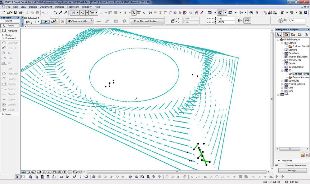

Hello ! This is a very interesting topic. I have tried in the past to import into AC 14 an organic shape made in Revit but it only recognized the standard vertical and horizontal geometry. How did you import this organic mesh? Is it seen in AC as a network of beams?
Hi Coty82,
You can test the import for yourself (I don't have access to archicad myself) from the ifc files included in this zip file:
http://ssi.wikidot.com/local--files/2011-blog-posts/110519%20Great%20Court%20Roof%20ifc%20models%20a...
Note that the architect was using AC v13 to import (we never got to the bottom of why v14 couldn't read it), I haven't had any reports about success or not in v15.
Revit can be particular about whether items are "beams" or "columns" so it's possible that might be related to your issue about non vertical or horizontal elements.
I'm happy to advise further.
Cheers, Jon
I `v been able to open it in AC 14 but it seems that some of the beams are not visible. When i check their settings, and choose undo roof trim, they do appear (the green ones wich are selected)
I quess there must be a problem in AC 14. .
Also, would it be able to open circular beams? Because as you mentioned, i see that all beams are straight
Interesting that as you first mentioned, it only seems to show horizontal members. If anyone can comment on this, I'll gladly produce variations of this model that might lead to all members being generated.
IFC can convey non linear members, to be IFC certified for coordination it is not mandatory to acknowledge many of the useful shape representations available. Typical software venders would "mesh" a non linear element into a faceted brep.
