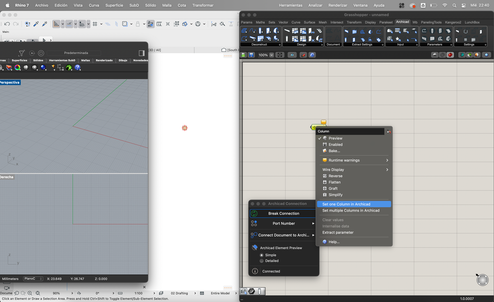

Hello everyone, I have a similar problem. I have tried uninstalling, reinstalling, manually deleting residual files and nothing works. I have Archicad 26 and I am trying to connect it to Rino 7 without success. I tried changing the file name and I have the same problem as them. Archicad is connected to Grasshopper, I can even bring in settings such as layers or pens, but when I click "set one element in Archicad" nothing happens, I cannot link Archicad elements with Grasshopper and the same if I create an element in Grasshopper, it does not appear in either Rino or Archicad.
Please, I need help.
I was able to get the add-on to work after installing it by re-running the latest AC hot fix.

We have the connection running on Archicad 25. Download the hot fix from the GS downloads page if you don't have the latest patch already and run it after you've installed the Archicad Grasshopper connection.
