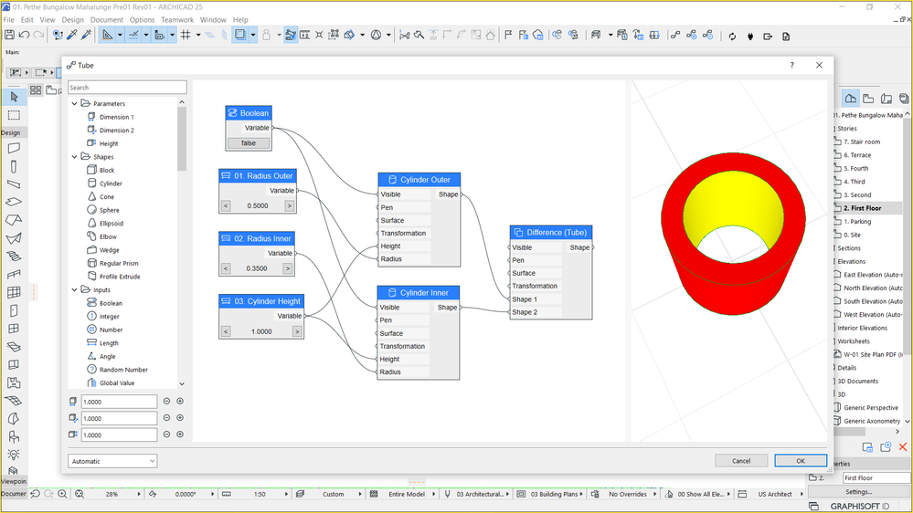

Hi, I hope you are looking for something like this. Download and check this video clip.
https://drive.google.com/file/d/1TqtknHP1wRnTiDe_GB9zUjiazXQS2Juq/view?usp=sharingParam-O Tube.png

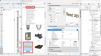

I was working on some objects but i stucked when i need to create custom 3D text. I will be obliged if someone could help on that.
Thanks
I guess you have posted on wrong forum. Still the one possible answer for your 3D text requirement is from "Object" tool "3D Text"

Thanks for reply Rajesh!
My question is that- Can we create parametric 3D text in Param O? Yes it's already available in objects but Is it possible to create 3D text (like 3D Room Tagging) in Param O as like Dynamo?
