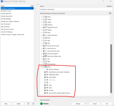

Have you checked your Element Transfer Settings to make sure Zone Category is selected as an option to transfer when applying favourites?

There is no Zone Category in the Element Transfer Settings options.
