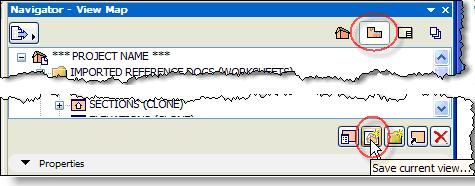

To understand Clone Folders, let's start with the basics of creating Views and ordinary folders. To create a new View in the View Map, click the Save current view… button at the bottom of the Navigator.
Each View records:
  • a place in the project (e.g., the second story, or the front elevation)
  • a Layer Combination (what layers are turned on, thus determining what elements will be shown)
  • a Scale (the size for printing purposes)
  • a Model View Option (how to represent elements, e.g., walls with detailed composites versus poched versus simple parallel lines, or doors shown with swings versus simple framing outlines for reflected ceiling plans)
  • Other information such as Dimension style, Floor Plan Cut Plane, Zoom, Pen Set, etc.
Thus each View is a well-defined "style" for how and what to show in a particular area of the Building Information Model. These Views often correspond to Drawings, and set the standard for how a certain drawing type (e.g., floor plan, reflected ceiling plan, etc.) will be created. Other times, Views are used to record a way of looking at BIM information for other purposes, such as while working on part or all of the design in 3D.

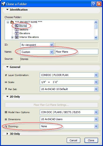

In the ensuing dialog box, you can specify which Folder from the Project Map structure will be referenced: Stories, Sections, Elevations, Interior Elevations, Details, Worksheets, Schedules, etc. You also choose the appropriate Layer Combination, Scale, Model View Options, etc., in exactly the same way as when defining an individual View.
I recommend that you give a custom name to your Clone Folder (e.g., "Floor Plans" or "Structural Plans") rather than using the generic name for that "viewpoint" (e.g., "Stories”). I also find it useful to define the Zooming as None, which allows one to go back and forth between different drawing types by double-clicking on Views without causing the zoom to jump around.
Separate Clone Folders for the Stories of the project should be created for each type of plan drawing you intend to use: Floor Plan, Reflected Ceiling Plan, Electrical Plan, Room Finish Plan, Structural Plan, etc. Each clone records standard View settings: Layer Combination, Scale, Model View Options, etc. As an example, by defining the standard for Structural Plans, that Clone Folder will automatically contain a Structural Plan View for each story, whether the building is one story, three, or 30 or more.

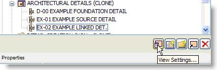

If you look carefully at the View Map, you'll notice that the symbol for a Clone Folder has a miniature version of the symbol for that part of the Project Map.
The icons that look like plain folders above are not Clones, while those with graphics are Clones. You may choose to label their names to emphasize which are Clones, as in the excerpt above. This can make it easier to work consciously with each folder type.

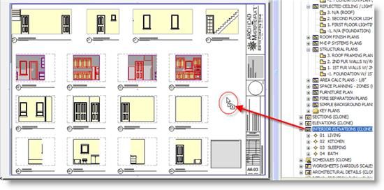

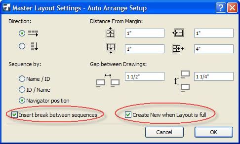

Once the View definition for Interior Elevations is set up as a Clone Folder, every view for all the rooms is ready to be annotated and placed onto Layouts. ARCHICAD 11's new Auto Arrange feature for placing drawings on the layout makes this a snap.
You can drag the entire Clone Folder of all the Interior Elevations onto a blank Layout, and have ARCHICAD place all the drawings automatically.
The drawings for each room will be placed in separate rows, and ARCHICAD will add more sheets as needed until they're all set up!
