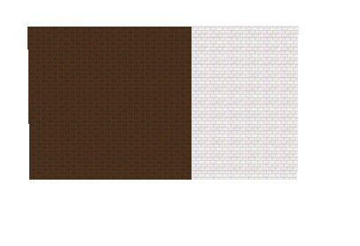

winscoat right?
i need to split plaster vertically (see image)
creative wrote:
winscoat right?
you just split them
Split wall with split command and applay diff.material
