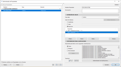

How can I use a property label in a zone if the property is a expression based property?
There is no option, neither if the label is an autotext field with the property.

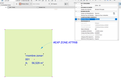

An auto text label of a expression based property doesn't work in a zone element. The label doesn't show the value of the property. I can't attach a screenshot right now to show you.

Hi Barry,
I'm trying with Archicad 27 4030 SPA and Archicad 26 5002 SPA.
I have realized that the problem is with the Surface attribute of the zone element (I don't know if it happens with another zone attribute).
If there is an option in the expression with Zone surface attribute, doesn't work the label, but the value in the properties is correct.
When I delete the option with the surface attribute, the label works correctly.
The problem is that I need to use the zone surface attribute in the property.
Carlos
