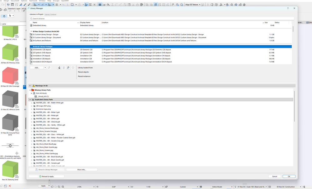

Hello Everyone,
I have recently migrated my Archicad 28 template to Archicad 29 using the Central Innovation Migration Launchpad.
The migration process appeared to complete successfully with no reported errors; however, I have noticed that the door tags and door labels are no longer functioning correctly within the migrated template. The tags either do not display the expected information or are not reading the door data properly.
Has anyone experienced a similar issue when migrating from Archicad 28 to 29? If so, could you please advise what may be causing this and the best way to resolve it?
I am also interested in hearing about any other issues or items that users should be aware of when migrating templates to the new Archicad 29 library packages. With the transition from the previous Australian library setup to the new global library packages system, I want to make sure I haven't overlooked anything that could create problems later on.

I have tried unlinking my external libraries and also checked all the MVO settings and compared to the default template.

Is there a reason you are loading multiple libpack languages?

I tried to it with just International (Australia based) but also tried loading all of them to see if that would fix the issue.

I notice your 29 template was using the 28 library packs.
So I deleted those and loaded the 29 library packs.
Still no Tags & Labelling page.

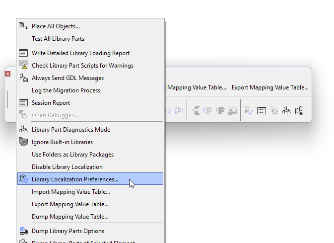

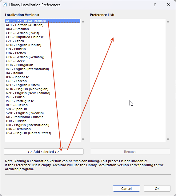

I noticed your template does not have a localisation preference set, so I did that.
No change.

Yes, I have tried everything I can think of so far, including setting the localisation preference to Australia as a test, but unfortunately it didn't make any difference.

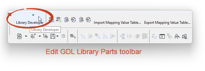

@Shir_2025, I went and loaded my own library mapping table and the Tags & Labelling UI is there. My guess is that you guys have modified one of the values that toggles that part of the UI. This would explain why Barry loading the DACH library worked as they have seperate listings within the mapping table. Unsure which value it might be, as the two that I managed to find regarding store doors and bomb shelters do not appear to be different from default.
