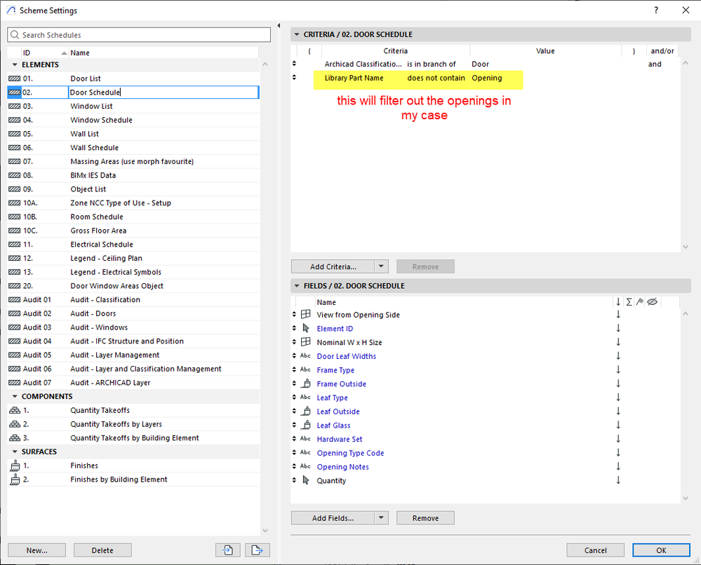

Greetings, archtop openings show a door marker, but they don't show up in my door schedule. I'm using the simple door schedule. Is this just a glitch in the system? All other doors and openings show up in the schedule.

What is the criteria for the door schedule set to find?
Lingwisyer
Guru
Are they classified as a Door, not just and Opening?
Under DOOR SIMPLE (criteria) the element type is door
I don't have a 'Door Simple' schedule.
The default one I have has criteria to not show the opening.
It is also using the 'Classification' of door rather than 'Door object'.
Maybe yours is using classification as well and the opening is not classified as a door as Ling suggested?
