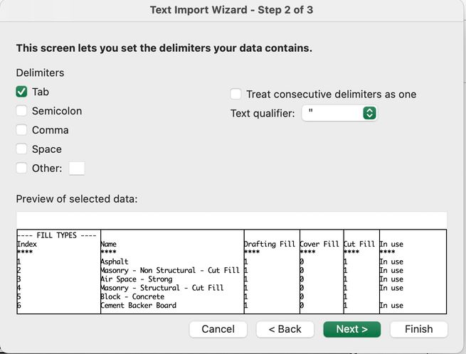

@gdford wrote:
It seems totally bizarre that we can't export to excel.
Does Windows Excel not let you open TXT files and choose how to read the data into columns?  This is part of what I see on Mac Excel when opening an exported list of Fills as TXT...
AC 29 USA and earlier   â€¢   hardware key   â€¢   macOS Taho 26.1 MacBook Pro M2 Max 12CPU/30GPU cores, 32GB
I have never tried that ---
