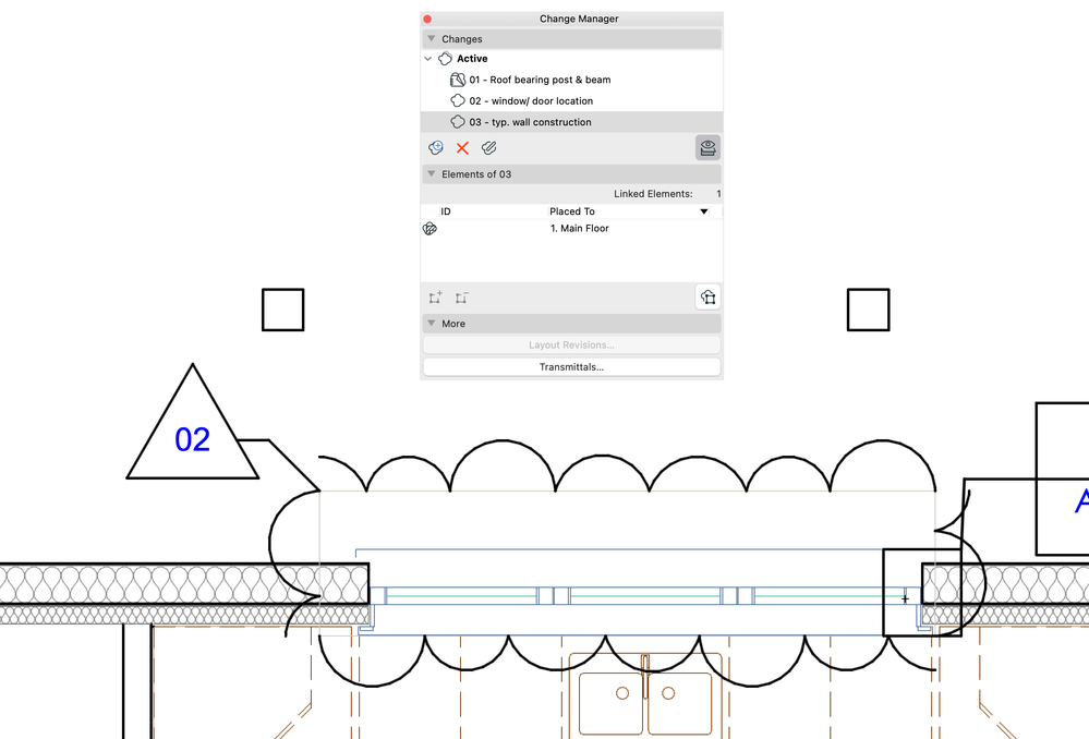

hey all,
I have used the change tool to place some new linked change markers. in the views they are correct, but once printed to PDF the change ID's change. see pics attached. the id of each change is correct in the change manager, they are linked to the correct change and they appear correct in the views, so i don't get it.
Solved! Go to Solution.
2023-03-14 06:40 PM
ok, i found it. in the change manager, select transmittals and there choose the numbering of changes in revisions tab. there you can select use change id or number by revisions.
