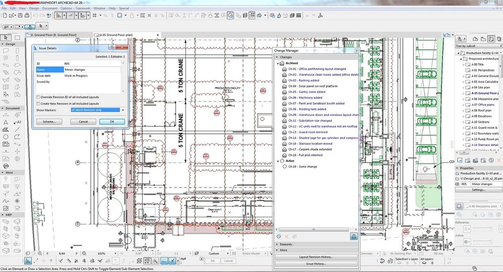

I don't get one thing: What is happening with the change markers after I close the Issue?
I have ~25 changes placed over more than 100 layouts and 300 views. Big project, many changes. I did archive the changes but I don't want to delete them. I want to hide them.
Do I really need to open all views one-by-one and put the change markers to a hidden layer?
Isn't it should be done globally with a single click? What is the point in archive then?

In the Layout Book tab of the Navigator, right-click the Book at the top of the tree and activate the Issue Details option. In the appearing Issue Details Dialog, set the "Show Markers" field to the "of latest Revision only" value.
It is "show latest" by default. I'm at revision 5, all markers archived at revision 2, 3 and 4 are there unless I'm hiding the layer.
Then I think this is either a bug, or it is a file-specific problem.
I tried this and for me this setting worked: Changes belonging to previous Issues were hidden in all Viewpoints and Layouts.
I think I know what is going on. (Had the same problem.)
All change markers remain visible on views. The "show markers on latest revision" refers to layouts. Previous markers will appear on a layout until that layout is added to a new issue. That confused me at first. Try this: Create changes and add change markers as needed. Create new issue. In the LAYOUT BOOK, make sure that the correct changes are attached to the right layouts. In the BOOK SETTINGS, make sure that the layout is included in the current issue. (This is what I had missed.) Finally, update the layouts in DRAWING MANAGER. After that, the previous change markers should disappear from the layout. Layouts not included in the current issue will still show the previous change markers. The entire history of change markers will visible in the view.

Hi All, the change markers should not be visible with the "show markers of latest revision only" setting. This is an error on our end, and it is planned to be corrected in the next update! Thanks for letting us know, kata
