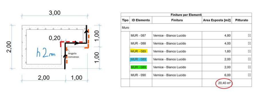

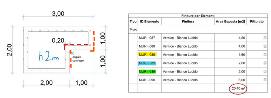

Hello everyone,
I am trying to obtain a correct automatic calculation of Exposed Surfaces through a Schedule in Archicad, using the “Exposed Surface” field.
In the case of simple geometries, the calculation works correctly.
For example, I created a small room with four walls, each 2 m long and 2 m high (so the plan only contains concave corners).
I assigned a specific finish (white glossy) to the external surface and activated the “Connected Walls” option.
In this configuration, the total exposed surface is calculated correctly:
4 sides × 2 m × 2 m = 16 m²
I have attached images for this first case.
The issue appears when the geometry includes convex angles (generated when the perimeter steps inward).
In these situations, the exposed surface value becomes higher than expected.
From what I can understand, at the points where two walls form a convex angle, the calculation seems to include an additional strip equal to the wall composite thickness where the surface is applied.
It looks as if a portion related to the wall thickness in plan is also being counted, which results in an overestimation of the actual exposed surface.
I have attached images showing this second case as well.
My questions are:
Is there a correct method to calculate exposed surfaces in this situation?
Or am I doing something wrong in my setup?
Any clarification would be greatly appreciated.

AllanP
The problem:
2 of these 3 walls should measure 1.6m
If i was trouble shooting this i would look at the 2 possible answers:
the reference lines are on the incorrect side
you can show the wall and beam reference lines under
View -> On-Screen View Options -> Wall & Beam Reference lines
or
a bug  where the wall is accidently measuring the wrong side for some reason.
I would change ID's from MUR-089 to unique IDs so you can identify which one is failing.
there maybe another explanation that you have overlooked.

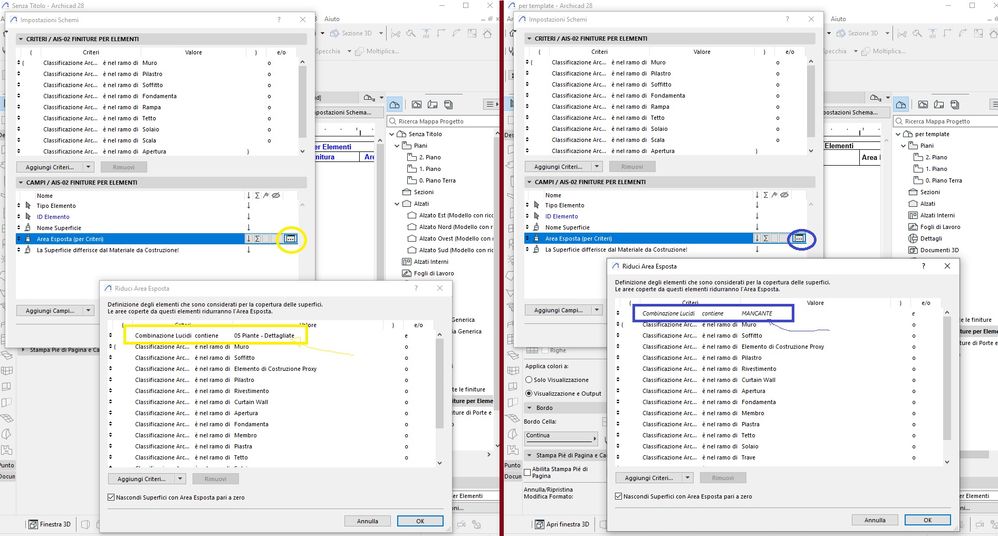

LucaLeo
Hi everyone,
First of all, I would like to sincerely thank all of you for your replies and for the time you spent helping me — even just taking a screenshot and checking the result on your own computer with your version of Archicad.
Every suggestion and every screenshot I received was extremely helpful. They allowed me to run further tests, question my assumptions, and work toward solving the issue — or at least I hope I have solved it, since the latest tests have produced positive results.
The fact that some of you used the same version of Archicad as mine and obtained the correct result made me reflect. I therefore tried working in a completely new file, without the template I have been using for a long time, and started analyzing the differences in the schedule and in the way the geometry was constructed.
At one point, I even performed a simple copy–paste (Ctrl+C / Ctrl+V) of walls modeled in a new file without the template, pasting them into the file where I use my template. Even though the walls were identical, the results were still different: in the template file I was getting the incorrect value (20.40), while in the other file the result was correct.
By carefully comparing the different fields, I noticed that in the template file there was a missing layer component in the field. I first tried assigning all visible layers, then assigning a specific layer I had created, and finally even deleting that field entirely.
After performing one of these operations, the calculated surface areas became correct.
I ran additional tests by inserting windows — both with the frame set to the wall material and without — and by modifying the wall height (for example, changing them from 2 meters to 3 meters) to verify the results. The final outcome was positive: calculating perimeter multiplied by height gave the correct surface area.
I am attaching a screenshot showing the two windows side by side, to highlight the difference that was causing the incorrect result.
I still do not fully understand why this was the source of the error, nor whether this is the proper approach or simply something obvious that I had overlooked. I had never noticed this discrepancy while comparing the settings before.
At the moment, by a process of elimination, removing or reassigning that field resolves the issue. However, I still cannot understand why, despite never modifying that schedule, that parameter was missing in the template file.
If anyone has further insights or observations on this matter, they would be greatly appreciated. I would really like to better understand what happened.
