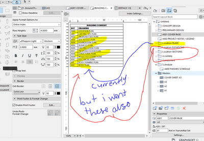

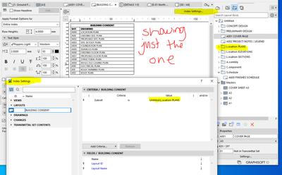

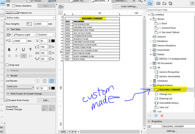

Hi there, I am trying to add multiple subsets to my custom-made project index and having trouble when I more than one to the list where none of them show up. Can someone please advise on how to fix this?
Screenshots attached.
Thanks, Hayley
Please Help!!!!

Hi
you need to switch this small and  to an or. A layout cant be in two subsets at the same time. The and is suggesting that it could be...
and if you want to add different criterias other than subsets to this list, you probably need to add brackets to those subsets. this avoids logic flaws in your criteria set
ArchiCAD 27 GER / Win10
