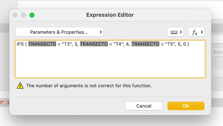

2024-03-20
08:51 PM
- last edited on
2024-03-26
08:26 PM
by
Hi, I'm getting the same error and I think the syntaxis is ok. Can you help me with this?
Jim

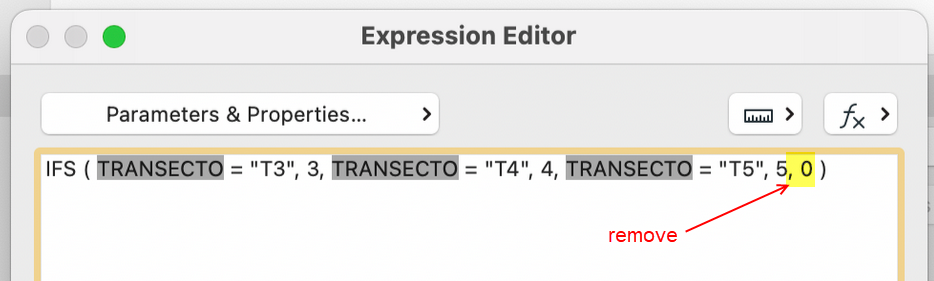

2024-03-21 02:47 AM - edited 2024-03-21 02:47 AM
What happens when you remove the last ... ,0
It is not part of the argument.
2024-03-21 09:04 AM - edited 2024-03-21 09:05 AM
As additional information:
if you like to add a result (0 in your expression), if none of the other conditions are met, you can do it by adding a TRUE as last argument:
IFS ( TRANSECTO = "T3", 3, TRANSECTO = "T4", 4, TRANSECTO = "T5", 5, TRUE, 0 )
2024-03-21 04:40 PM
Thank you so much. Indeed I wanted the "0" as the result if any of the conditions were true.
