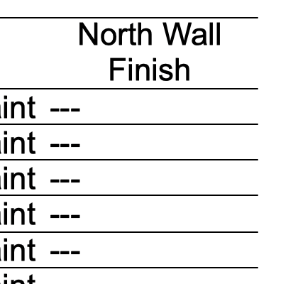

Working on a room schedule for a project. Currently trying to get the wall finishes into the schedule. I have under properties - Zones - North wall finishes set but when I add that field to the schedule all they show up as is ---. I have it set on all the zones but they all show the same thing. I attached photos of the issue as well

I got it figured out. I was using the pre-made "Room Legend" under surfaces. I redid it under elements and they showed up then.
