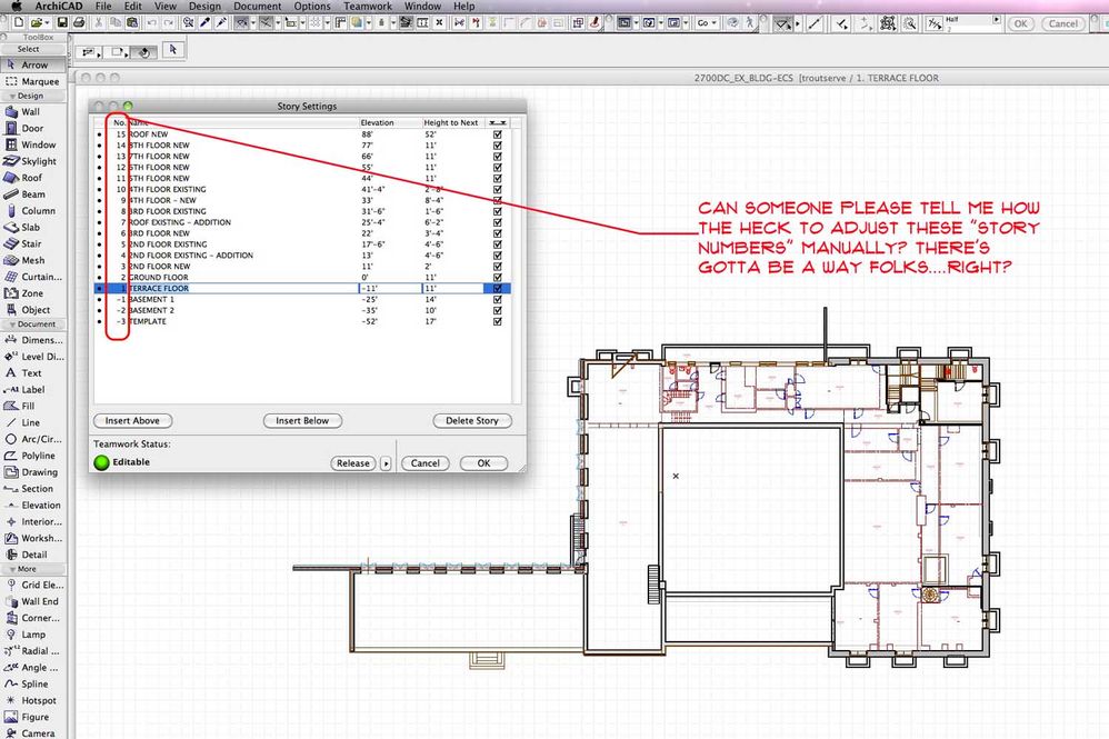

HOW CAN I ADJUST THE "STORY NUMBERS" MANUALLY?
Come on folks...GS with all it's infinite wisdom must have made a provision to adjust the "story numbers" manually......please say there is a way.
This is causing major havoc on our teamwork/hotlinked files.
Please...tell me there is a way.
If not I'm going to have to CUT/PASTE all my TW information, story by story, into a new PLN file, then have to re-share and re-hotlink it....so please...tell me there's an easy way to adjust these numbers.

I'm certainly no expert in IFC and Teamwork, but you can always insert ZERO height floors to get things to correlate. Also, it looks like something kind of weird is going on with your second floor heights. Shouldn't these all be the same? (Why are you putting new & existing on separate height stories?)
Richard
AC26 (since AC6.0), Win10
While I don't understand the approach you are using with your stories, I believe you are trying to change your Terrace Story from #1 to #-1.
The only way to do this is to insert a new story below story #1 (a new #-1 story) setup with the same heights as the #1 story, turn on all the layers on story #1, select all, copy to clipboard, move to the new #-1 story, paste to original locations, and delete the original #1 story to move all the stories above one number down.
I would save first.
rob2218
Reason we need to put "new" and "existing" on separate heights is because the "new building" has different heights floor to floor than the existing building.
We were told that we needed to make sure both "NEW BLDG" and "EXST BLDG" teamwork files had the exact same floor naming convention as well as the exact floor to floor heights.
But never did I imagine that the darn little "story number" on the left hand side would throw such a monkey wrench in how this existing building (remodel) teamwork file hotlinks in to the new building teamwork file.
Right now....the "NEW BLDG" teamwork file isn't reading the windows properly.
Compound the fact that the darn "Existing building" came from a sub-consultants IFC translation.......which just adds to the whole mess of things here.
When I merged/opened the IFC file the subs gave us....it came in with those settings as shown, where the ground floor was story number 2......but now that's causing a hellacious problem when it gets hotlinked out of the teamwork file we needed to share on both the "NEW BLDG" as well as the "EXST BLDG"....
Not to clear on making a new story and cutting pasting form the others...I tried that and it didn't bump down nor bump up anything.
Must be doing something not right.

Erika Epstein
Rob, When working with building which have different story heights you want to have each building in their own file and Hotlink a story by story module into the other files.
The first time you bring in the separate story files you will have to vertically drag each story up/down until the stories align properly. After this initial adjustment updating the hotlinks will not cause this step to be repeated.
Erika

As perhaps you have figured out by now, the story numbers are not editable, but this should not be a problem. When you place a multi-story hotlink it will ask you which story to align with your current one so you you can get around a difference in the story numbering.
On the other hand, linking projects with different story heights can get quite complicated.
The easiest way is probably to link single stories and adjust the linked modules' elevations to the host files story settings. One limitation/caution to this approach is that you have to make sure that doors and windows are all referenced the base elevation of the wall rather than to their home story (I assume this to be the source of your window problem). Another issue is that SEOs between element on different stories will lose their relationships when linked into another file story by story.
The other approach is to create a master set of stories with each building's stories interleaved with the other's at the appropriate differentials. This may require a one time reorganization of the models story by story to get things at their correct relative levels. This can either be done by cut and paste between stories (with all layers on and unlocked) or by hotlinking the old models story by story into a new empty template and then breaking the links.
There are more subtleties and the details depend an the particulars of your project, but hopefully this will help you get things sorted out.
