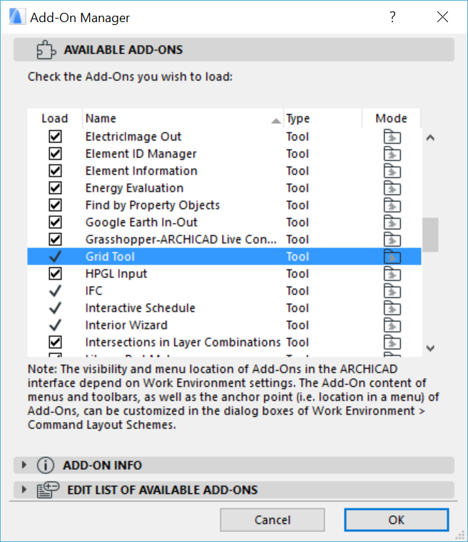

This is the Add-on Manager confirming that the Grid Tool is Loaded:

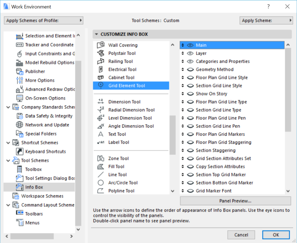

Finally switch on/off the Panels for the Grid Tool's Info Box display: (This settings will show all related panels, of course you can narrow it down and show what you need only.)
