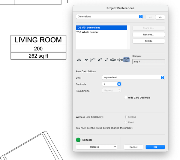

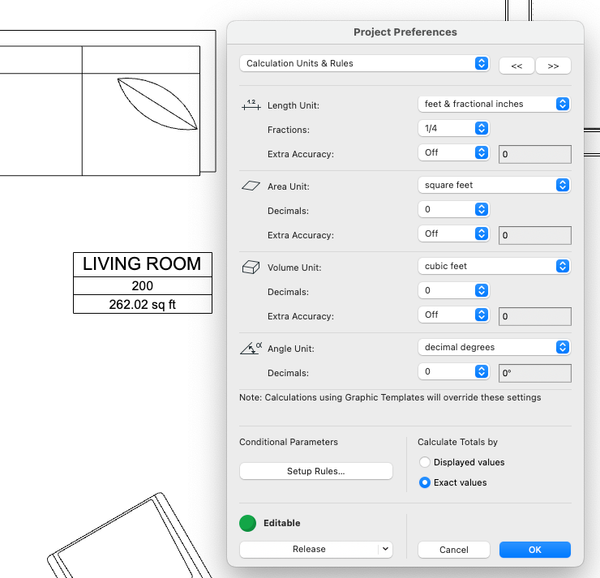

Hello!
May I revive the original question? I too cannot change the # of decimals in the zone stamp calculated area. I have updated my Project Preferences - Calculation Units & Rules.
I cannot find any sort of View Setting that will make the zone stamp change to 0 decimal places for square feet of calculated area...

Found it! You have to click on the "Area Calculations" icon under "Project Preferences > Dimensions", and either overwrite your dimensions, or keep a custom dimension setting for that view.
Hope this helps someone someday....
