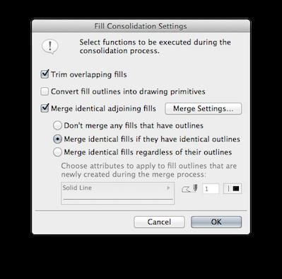

The user selects all the fills that are to take part in the Consolidation process. The Fill Consolidation command (Edit > Reshape > Fill Consolidation) brings up a Settings dialog box, in which the user checks the options to execute.
At the top, in the Ignore Attributes section, the user defines which fill attributes (Layers and/or Categories) the program should NOT consider when determining whether any two adjoining fills are “identical” before merging them. For example, if the user checks “Layers”, then identical fills will be merged even if they are on different layers.
The Merge Settings button opens a dialog box in which the user can then choose a layer/category for the newly merged fills. For example, if fills on different layers have been consolidated, then the new fill will be placed on the layer chosen here.
Trim Overlapping Fills: Any selected fills that partially or entirely overlap each other will be trimmed so that only the top fill remains; any other fill (or part of a fill) that is covered up beneath the top fill will be deleted.
  • Note on Overlapping Fills with Transparent backgrounds: If the top-level fill has a transparent background, any solid-background fill beneath it will remain intact, because it will be visible.
  • Exception: If there are multiple transparent fills atop each other, only the top-level fill will remain in full; any fills or parts of fills underneath, if they have transparent backgrounds and are covered by the top-level fill, will be deleted.
Convert Fill Outlines: Any fill contours will be exploded into simple line segments/arcs.
Merge Adjoining Fills: Any adjoining fills (regardless of display order) which have identical fill patterns/colors will be merged into one. The resulting fill will carry the ID of the largest of the original fills. If the user directed the program to merge fills even if they have different layers/categories (“Ignore Attributes”), the new resulting fill will be placed on the layer/fill category chosen in the “Merge Settings” sub-dialog box. Fills that have different pattern orientations (project origin/fill origin/distorted) will not be merged.
  • Outlines of Merged Fills: You have three different options for handling the merging of fills that have outlines.
    • Don’t merge fills with outlines: Such fills are not merged at all.
    • Merge fills with identical outlines only
    • Merge fills with any outlines
    • If you checked “Convert Fill Outlines”, these options are not available, since the fill outlines will no longer exist after the consolidation process.

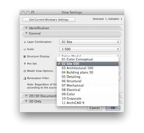

Pen Sets in Views
  • Assign Pen Sets separately to each View, using a new Pen Set pop-up in View Settings
  • Pen Sets are saved with and applied to the view
  • Easier modification of specific pens used in a drawing
  • Work on WYSYWYG model views
Pen Sets are available from the View Settings dialog.
