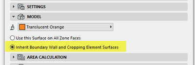

I wasn't sure it could be done but  think it can.
This is what I have so far.
A surface schedule with zones as the search criteria.
Add the fields you want - Exposed Area (by criteria) is what you want for the area.
But you must remove the criteria that would be deemed to cover the surface and reduce the surface area.
So make sure 'walls' are removed.
Leave 'slab' so the floor and ceiling area of the zone will be reduced when you model them - unless you want the wall and ceiling finishes as well.
I assume leaving doors and windows in will reduce the are by those objects (i haven't tested).
And the result (I have not modelled floor and ceiling slabs).
I hope this helps.
I forgot to say, make sure your zones are set to inherit the boundary wall surfaces.
