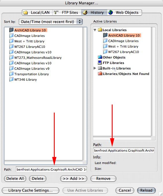

Hard to belive, I will try that. Is there a way of telling that if the one loaded is on the intended computer?
Thanks again,
Joseph
__archiben
look at the file path in your library manager . . .
