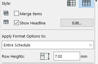

Hello,
I can't find merge uniform items in schedule in AC26?
I only have merge items which merges everything and i don't know why would anyone merge everything that is not the same.
Did the setting move?
Solved! Go to Solution.

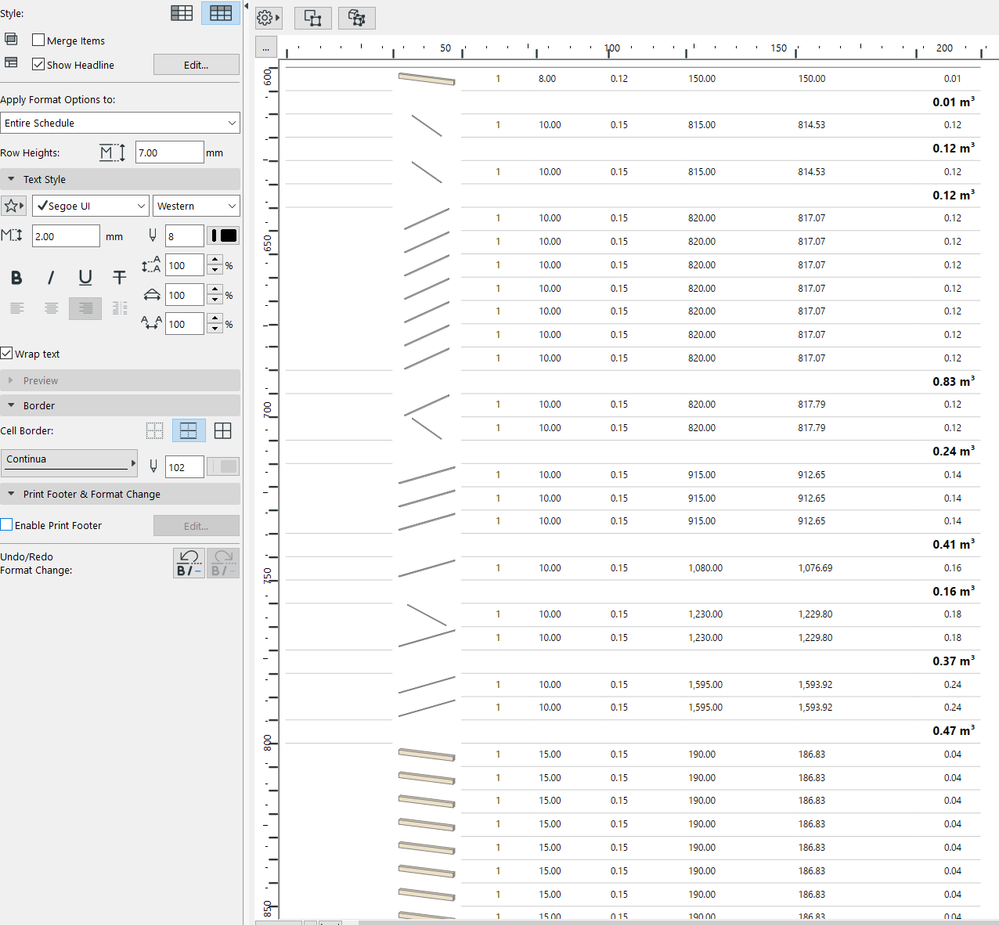

2022-10-08 10:46 AM
If you can share a s screenshot of schedule without merging?

2022-10-08 12:28 PM
I see the second column showing no. 1 should be eliminated as they are sharing the same property, that will eliminate merging all together.

2022-10-08 12:32 PM
But i want to merge them if they are the same size, and i want to show the quantity.
For example if there are 5 beams with same length, those 5 would merge and write 5.

2022-10-08 12:46 PM
Simply go to the size field and display the flag icon so it will give you a sub-total quantity and size for the merged beams.

2022-10-08 12:54 PM
Having hit the merge all it merges all even those who are not the same, i don't want to merge all, only the uniform items. I did click the flag, nothing happens.
