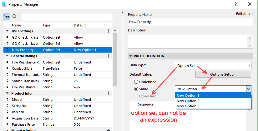

I am a little bit confused as expressions can't have an option set.
So I am not sure what they have to do with each other.
In the option set property, you can press the 'Options Setup' button and "Add' more options.

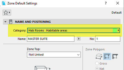

So if you are talking about this zone category (this is from version 22 - all I have open at the moment) ...
I am not aware of any way you can automate which category is used.

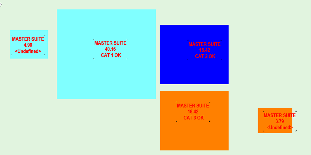

This is the text for the formula I used ...
IFS ( AND ( {Property:Zone/Zone Category} = "Category 1", {Property:Zone/Measured Area} >= 20 m2, {Property:Zone/Measured Area} <= 80 m2 ), " CAT 1 OK", AND ( {Property:Zone/Zone Category} = "Category 2", {Property:Zone/Measured Area} >= 15 m2, {Property:Zone/Measured Area} <= 90 m2 ), " CAT 2 OK", AND ( {Property:Zone/Zone Category} = "Category 3", {Property:Zone/Measured Area} >= 5 m2, {Property:Zone/Measured Area} <= 50 m2 ), " CAT 3 OK" )
Change the names of the zone categories to suit yours and you can change the "OK" response as well.
This will just give you a property value to say if the zone area meets your particular category requirements.
You can add more categories, at the end before the final bracket just keep adding this but change to your next category and min/max areas...
I hope this is what you are after.
You still have to place the zone with the category you want, but the property will tell you if it is OK.

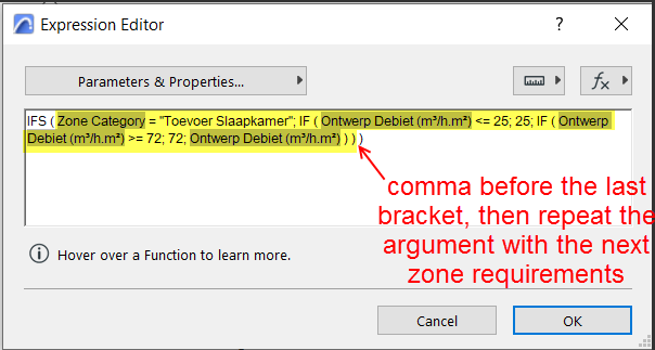

IFS ( {Property:Zone/Zone Category} = "Toevoer Slaapkamer"; IF ( {Property:Ventilatie/Ontwerp Debiet (m³\/h.m²)} <= 25; 25; IF ( {Property:Ventilatie/Ontwerp Debiet (m³\/h.m²)} >= 72; 72; {Property:Ventilatie/Ontwerp Debiet (m³\/h.m²)} ) ) )
This is the expression i use. This only works for 1 Zone Category. If i want to add a other zone category it gives me a error. The 10 zone categories all got a different min and max. Is there any possibility to add more zone categories?
Dear Barry Kelly
I want to thank you for the time and energy you put in to this. This is very helpful. This is not exactly what i need but its close. For my project the value needs to recalculate to the min/max.  Also i need to put these in a schedule.
I have just started work for the day so I won't get to play around with this and test it until later tonight (about 10 or 12 hours from the time of this post).
But it should just be a case of adding an extra argument, exactly the same format as you have but with the next zone requirements.
