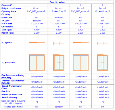

Is there a way to adjust the gs_bOpeningToZone(boolean) variable by setting it as a property?
I want to control the schedule.

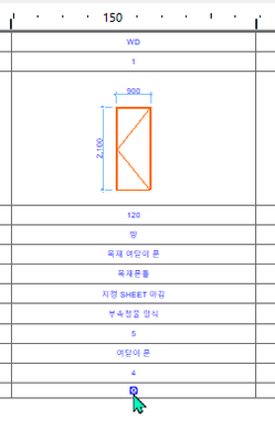

You can control it now in the schedule as you show in your screen image.
Are you saying you want to see it as a text option rather than a check box?
Or are you saying you can not turn it on/off?
LeeJaeYoung
It can only be viewed in the schedule, but cannot be turned on/off.
You should be able to control settings from the schedule.
If you can't then that probably means the layer combination for the view that you have used to open the schedule, has not got the layer turned on, or those door/wall elements are locked.
But I just had a quick look at a door schedule and I could not alter the door ID or size from the schedule.
I always thought that you could.
I do not use schedules very often, and don't have time to investigate properly at the moment.
I may be able to get back to it later.

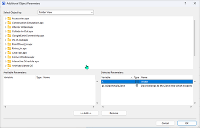

LeeJaeYoung
ID is an attribute, so it can be edited.
The size is in two, so editing is not possible.
Door to Zone on/off is a GDL parameter, but it cannot be modified on the spot. (In my experience ^^) It was a question about whether there is another method.
I cannot edit A (width) as it is also a GDL parameter.

I just opened a default template with a default door schedule.
Most but not all parameters are editable in the schedule.
At the moment I am not sure what would stop some parameters from not being editable.
I know the 'door leaf widths' shown in this image is a parameter in the door but it is not one that can be altered by the user anyway - not even in the object, so that is why it is not editable here.
I think I have found the answer.
Click on the 'Merge Options' button and set it to 'Uniform'.
It seems that it might default to 'Unifor or Various' which does not allow you to edit the values in the schedule.
And if you don't see the 'Merge Options' button, you must turn on the main 'Merge Items' option in the schedule settings.
