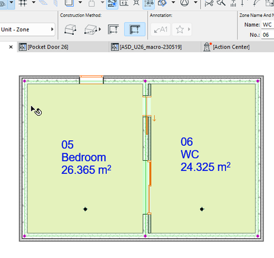

Manual zone cannot be from zone, to zone.
Auto zone becomes from zone, to zone.
Door belongs to the Zone into which it opens seems to work only with the code. ( I posted a question where it is ^^)
And the manual zone doesn't work either. can't it be? ^^
