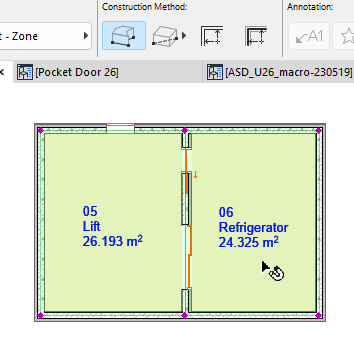

Is there a way to adjust the gs_bOpeningToZone(boolean) variable by setting it as a property?
I want to control the schedule.
Solved! Go to Solution.
2023-04-20 08:21 AM - edited 2023-04-20 08:24 AM
I think I have found the answer.
Click on the 'Merge Options' button and set it to 'Uniform'.
It seems that it might default to 'Unifor or Various' which does not allow you to edit the values in the schedule.
And if you don't see the 'Merge Options' button, you must turn on the main 'Merge Items' option in the schedule settings.

2023-04-20 04:29 AM
ID is an attribute, so it can be edited.
The size is in two, so editing is not possible.
Door to Zone on/off is a GDL parameter, but it cannot be modified on the spot. (In my experience ^^) It was a question about whether there is another method.
I cannot edit A (width) as it is also a GDL parameter.

2023-05-22 03:55 PM
Manual zone cannot be from zone, to zone.
Auto zone becomes from zone, to zone.
Door belongs to the Zone into which it opens seems to work only with the code. ( I posted a question where it is ^^)
And the manual zone doesn't work either. can't it be? ^^
