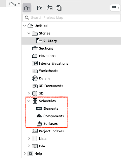

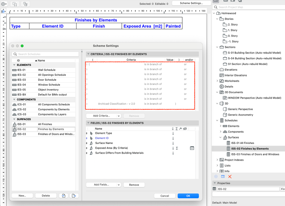

I needed to start off one of the pre-canned schedules for surfaces, I clicked on it, but it isn't listing anything from the project. I went into its Settings and saw that all the 'is in branch of' criteria are empty:
Weird, I thought. I did a 'New & Reset All' and see this:

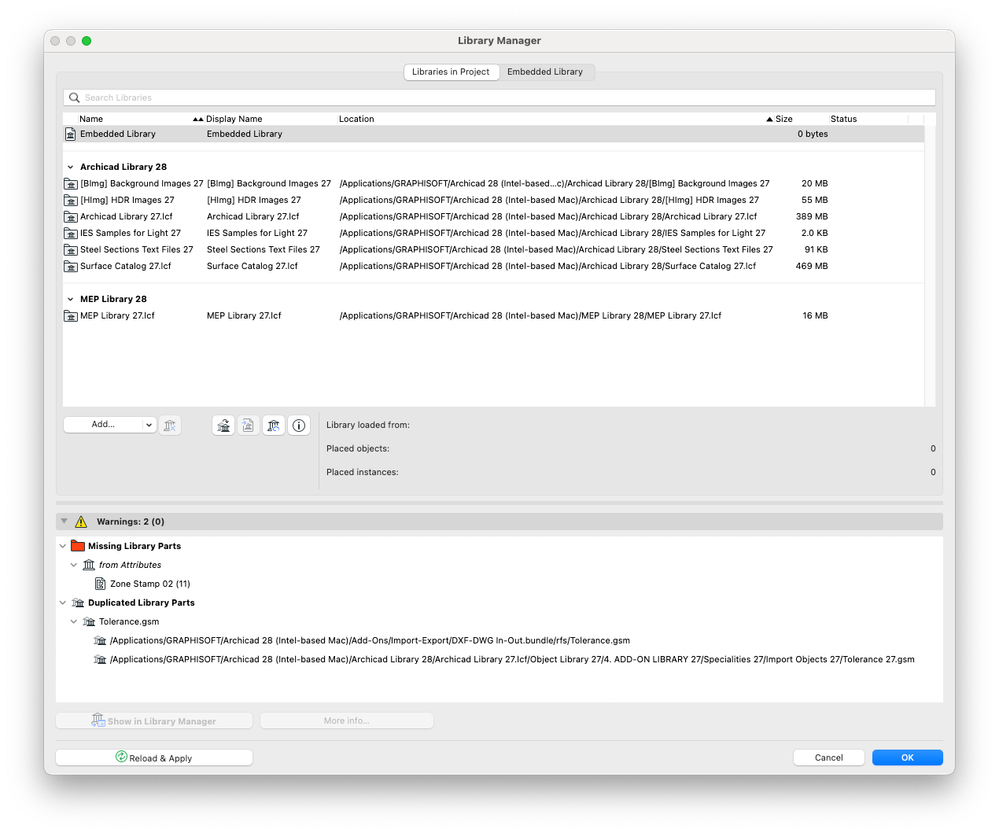

Here's what's loaded in my Libraries:

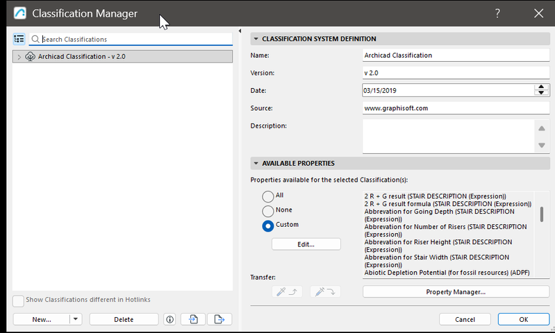

Hi @alexliz
Is the Archicad Classification - v 2.0 available in the Classification Manager?

Ricardo Lopez
Hi @alexliz

Thank you both. I have Archicad Classification - v 2.0 loaded, but it's from a different location on the hard disk (I have exported the set from a past template) so I am guessing Archicad is treating it as different. I am now resetting the criteria based on the loaded set.
As for the New & Reset All: I was starting the new project trial project based on a template that did not include any schedules - my bad. I selected the AC28INT template and all is good.
