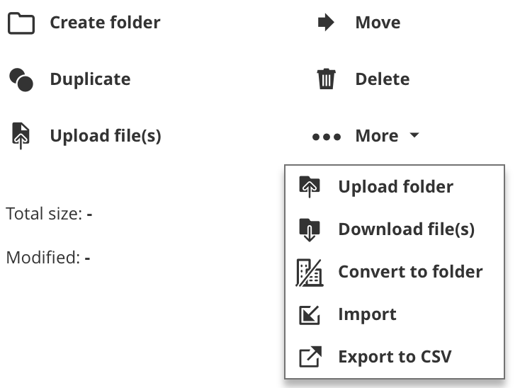

Once your BIMcloud Project has been created, you can start managing your project, by creating folders and uploading the necessary files, which you can do in any browser and on any device.

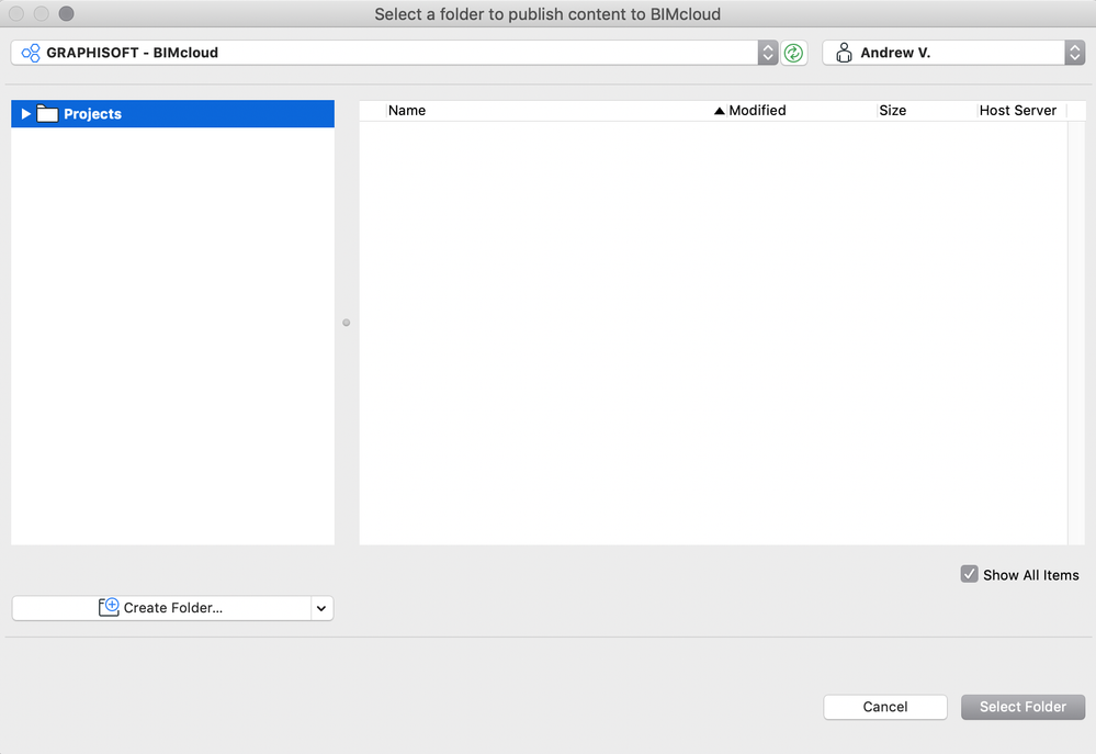

  • Publisher set
    • Publish any set of 2D and/or 3D documentation from Archicad directly to BIMcloud, select the folder you would like to publish to, and the teams having access to that folder will be able to view what you just published.

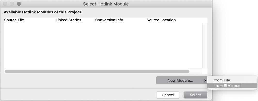

  • Hotlinks and Drawings
    • Place & Update hotlinks and drawings directly from BIMcloud.

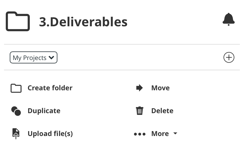

Folder and File Subscription
Subscription icon
Having BIMcloud acting as a multi-disciplinary model hub involves having many files you would like to keep an eye on. Use the Subscription feature and do not miss changes happening in a folder or in a file.
Let us take the example of our Deliverables folder. As a client, you might want to be notified when the architect team is publishing the latest set of documentation. Click on the bell next to the folder, it will turn from a white background to a black one. Next time there will be changes in this folder, you will be notified*.
* Notifications coming from the Subscription are displayed on the BIMcloud Management interface as well as sent to the user's inbox through the Daily Summary email.
