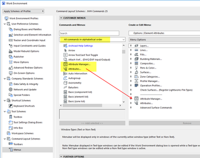

‎2023-03-11 03:38 PM
Ron:
Go to Work Environment > Command Layout Schemes > Menus and add Attribute Manager... to your Work Environment.

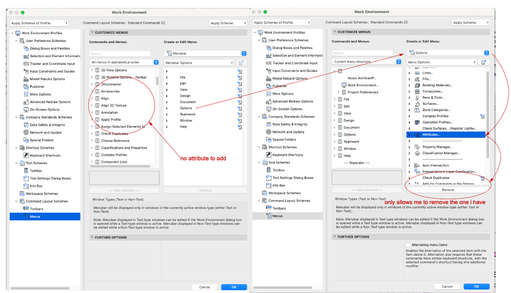

‎2023-03-13 04:30 PM
that does not seem to be available in mine see attached
and to Barry who suggested using standard work environment i keep an original file so I can reference any changes and it does does not exist there either

‎2023-03-14 03:23 AM
Change your WE to look for 'all COMMANDS in alphabetical order'.

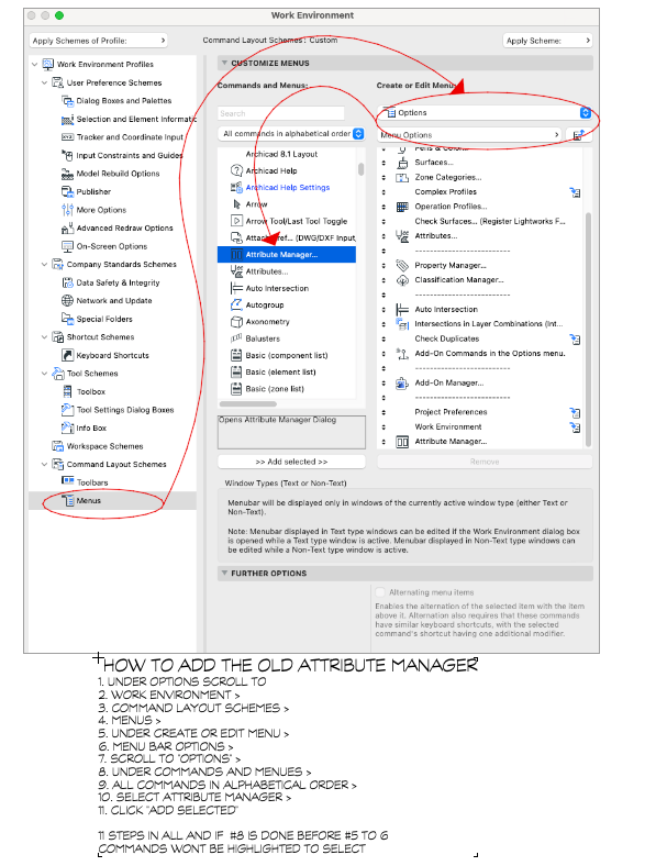

‎2023-03-14 05:12 PM
THANKS
I finally got it with your help and the diagram.
For info it was eleven steps in total to get there so I made a list and diagram in case I need it again. I've also attached it if anyone else in the future needs it since these one word answers of just add "X" or use "X" are not enough for me
