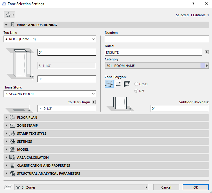

The zone selection settings are:

All of the elements are fully within the zone. Any ideas why this wall acts this way?

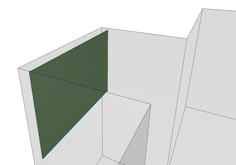

The wall is fully enclosed in the zone and does not touch any other zone.
Screenshot of the selected wall within the zone.
