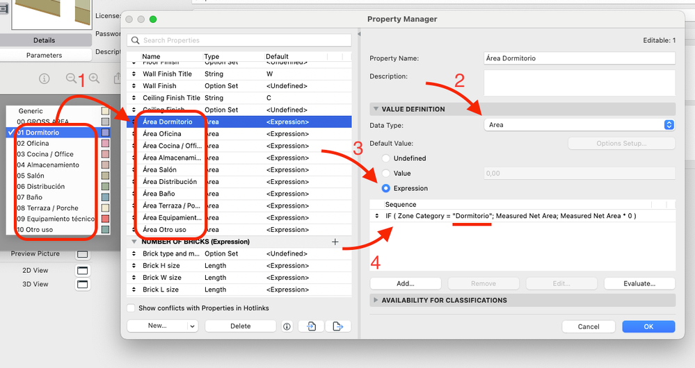

First you need to make the personalized zone properties:
Open the property manager.
1. Add a new property within the ZONES group for each zone category you want to have in your schedule.
2. Select data type Area
3, 4. Select Expression as default value and enter the value shown on screen, modifying that Dormitorio with your category name.

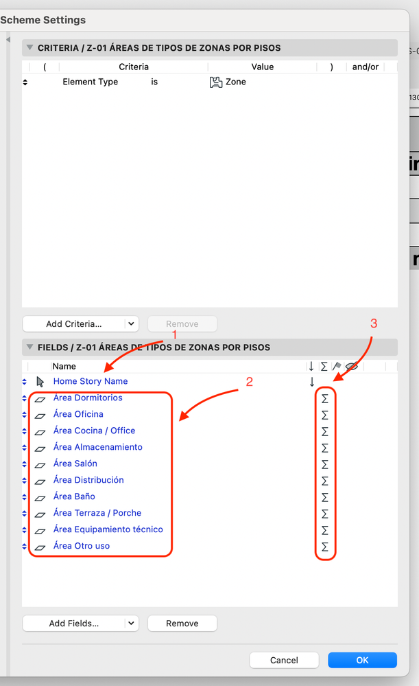

Then you'll configure the scheme settings as shown:
1. Add Home Story Name as the first property of the schedule.
2. Then add all the custom properties for each zone category you made before.
3. Make sure the sum option for all the areas is selected, which will give you a sum at the bottom of each category.

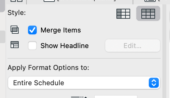

In the schedule window select Merge items

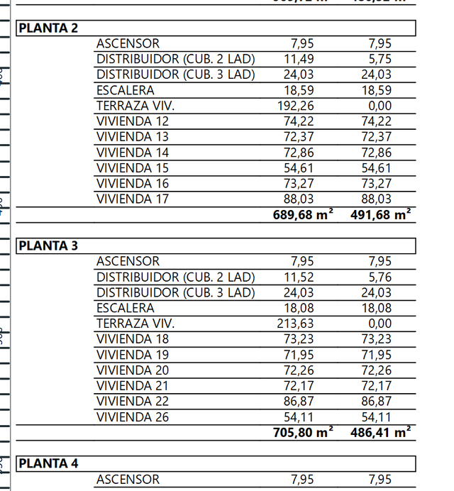

Then after some format editing, you'll have something like this!
So it is possible to do the table you wanted directly within Archicad, but it does take some preparation and effort. The easiest way would be as @Eugene said, instead of trying to make a more complex schedule and jump through a lot of hoops to accomplish what you have in mind, just export the list with all the necessary raw data and live-link and process the data within your favorite spreadsheet program.

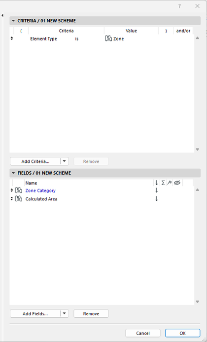

You need to use Element Schedule and try to get the desired result as in the below attached screenshots.

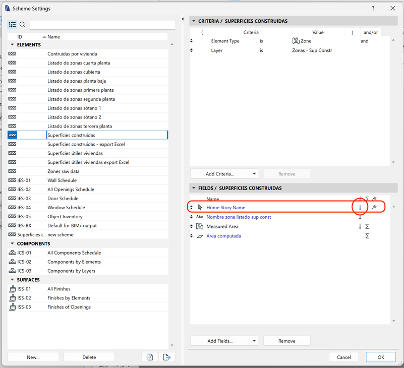

You'll need to add a level category (home story name), set it as the first category and select Order by value - Ascending.
