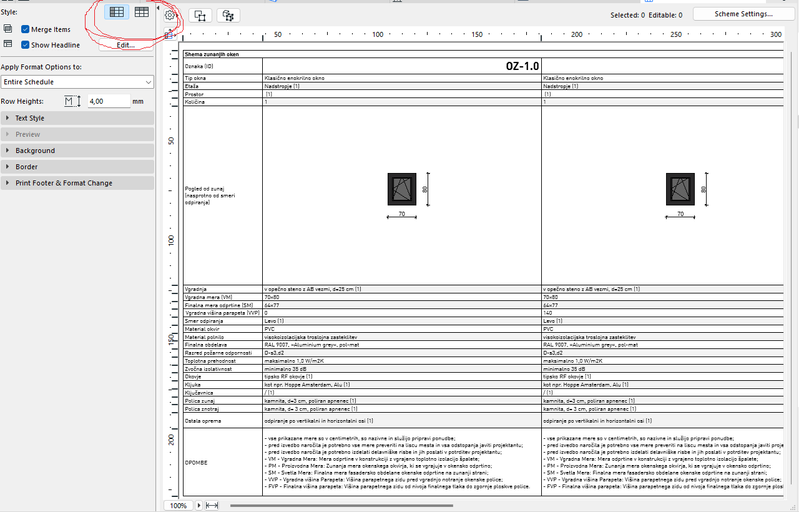

Rastko Pecar
try clicking on the red-marked button. It flips the field/value direction from top-bottom to left-right.
If you look at my window schedule and Imagine that the big bold window type ID is your room name then the lower displayed values could be your surfaces, yes?
Hope it works!
