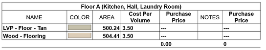

I am trying to create a living cost calculator for doors/windows/and surfaces.
I would love to build a schedule allowing me to price out all the items in the details sheet that could appear on their respective schedules and would change while I build or edit the model/floor plan.
One example, with doors, I would have two types of doors that cost different. Door A, a single swing door, would be 200 in total cost, while door B, four pocket doors, come to 300 each, however, the client may want to add another swing door in place of one of the 4 pocket doors. I would love to be able to go and switch out the door without having to go into Excel and update the schedule there.
In the image attached to this post, on the door schedule, you will see a cost at the bottom that remains at 0. Basically, I am trying to figure out how to times the quantity to the purchase price.
Likewise, when dealing with surface areas, I want to try to have the Area Column times the cost per unit/Volume to get a purchase price.
Essentially, I am asking if there is a way to have the Feild Lines interact with each other.

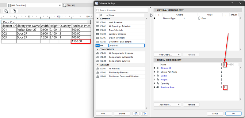

Ricardo Lopez
Hi @Nyarumian
Once you have assign the Purchase Price to the element (Door) you can create a schedule and select the purchase price field to be summarized, just clicking on the å symbol.

This Helped for Items like doors and windows or various other objects. Thank you for that. The other thing is trying to get pricing on surfaces to show up. If I have a Slab, with a top surface of a tile texture and I am trying to auto-calculate how much tile will cost in the schedule, do you know of a way to set that up?

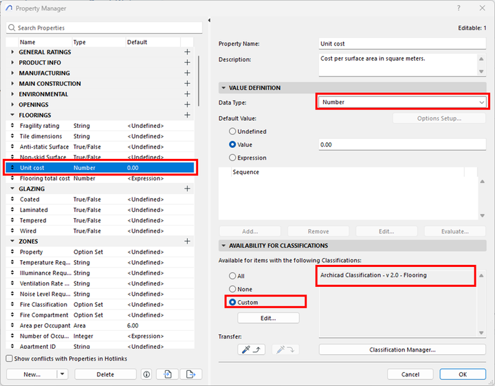

2. Create a new Unit cost property only available for flooring classification. It must be a number so you can set a different value for each one if needed.
3. Create a number property for the math, I will name it as flooring total cost. It is a simple expression:
{Property:FLOORINGS/Unit cost} * {Property:Slab/Surface Area of the Slab Top (Gross, with holes)} / 1 m2
Be aware of you need to divide the area by the unit (1m2). It will be available only for the same classification.
4. Populate Unit cost property for the flooring slabs.
5. Create a surface schedule where you set a criteria just for slabs classified as flooring covering. Add the properties you need and do not forget to set the summarize symbol (å) for the total expression.

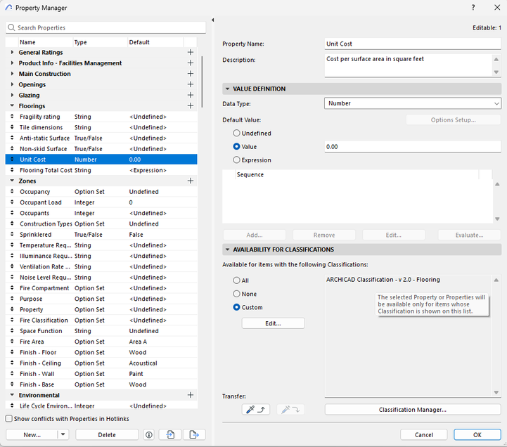

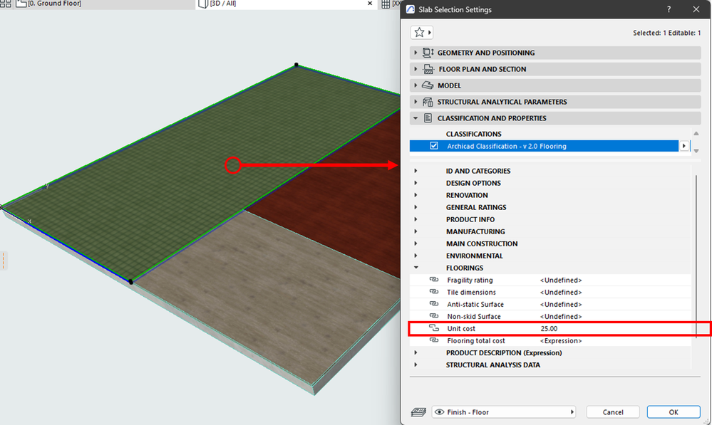

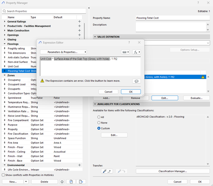

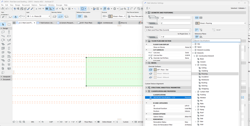

OfAnna
Thank you, this has been helpful, however, I am Having an issue with the sequence.
I changed the class of the slab
Created and set up the Unit Cost

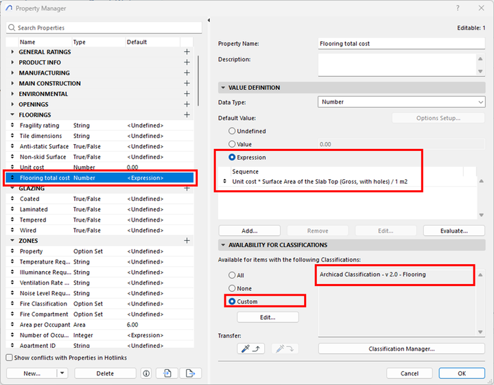

But as I setup the Total Property, there is an error.
This is what it looks like in the sequence.

RobPhill33
You need to change your data type from String to Number.
