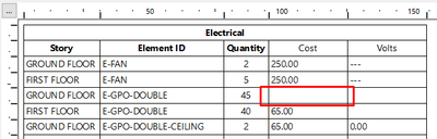

I have a schedule for electrical items which used to work until recently. For some reason the cost field isnt coming through for any items on the ground floor but it works on the first floor. I copied some GPO's from the first floor to the ground floor to test it out and this doesnt work. Hoping to get some advice on how to resolve this.

It's hard to say without seeing all setting of schedule. It may be some item on Ground floor has wrong classification or other criteria and value in this field is not shown, because probably "Marge items" is marked.
For the beginning, I would unmark "Marge items" and see what exactly the problem is with.

 Hi @jagber, I see you already got some cost property from ground floor items so you can first select this item in floor plan or 3D and check it’s properties.

Thanks, I'll check out the merge.
I copied the object from the first floor to the ground to test it out and it doesn't appear in the table. The properties are all identical.
If that doesn't work what can I send across to make it easier to find the problem?
AC26 AU • Windows 10 • i5-7200U @ 2.5GHz 16GB
It looks like one of the items is hidden + locked. I tried showing all layers but I cant seem to resolve this.
Exactly, and because of this one item, the value in the field may not be displayed when you have selected "merge items" .
This items is locked in the schedule because it was on a hidden layer when opening the schedule.
The easiest way to find it is to show all layers on the plan and then open the schedule.

Thanks for the help. I managed to figure it out before seeing this. I had to do this and I think unlock everything too.
