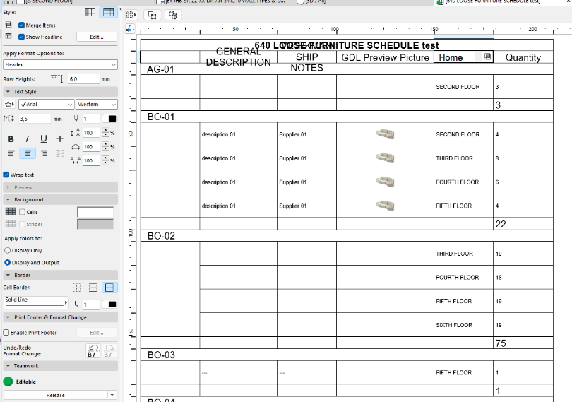

Hi all.
I would just like to know if anyone had experience in creating a schedule like this before?
I would like to have the amounts next to descriptions, per floor, and then a total of each item at the end... As per the pic.

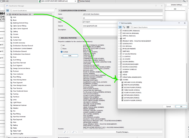

Because for each story property, you have to modify the formula: for example:
IF(Home Story Number = 4;1;0) for the fourth floor,
IF(Home Story Number = 5;1;0) for the fifth floor...
You wrote the same formula for each story, so the property verify if the object is in the ground floor each time

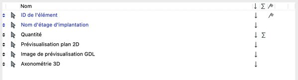

Hey Johan,
As far as I know, you won't be able to get exactly that type of schedule with the native tools but you can get pretty close
If you use these options (1) with the flag on ID and sum on quantity
You can get the items and their quantities per floor like so (2)
If you need to add description, you simply add in (1) the description/personalised text between the quantity (Quantité in my image) and 2D preview (Prévisualisation plan 2D in my image)
That's about as close as I can get it

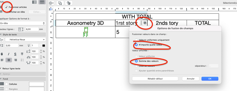

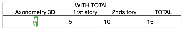

You can also use the "brute" force: as many properties as there are stories, a formula for each property (set to number) that verifify if the element is in the story (=1) or not (=0).
The merged properties should give you a result similar to your example.

I don't think I understand what you mean. Would that apply to the picture preview as well?

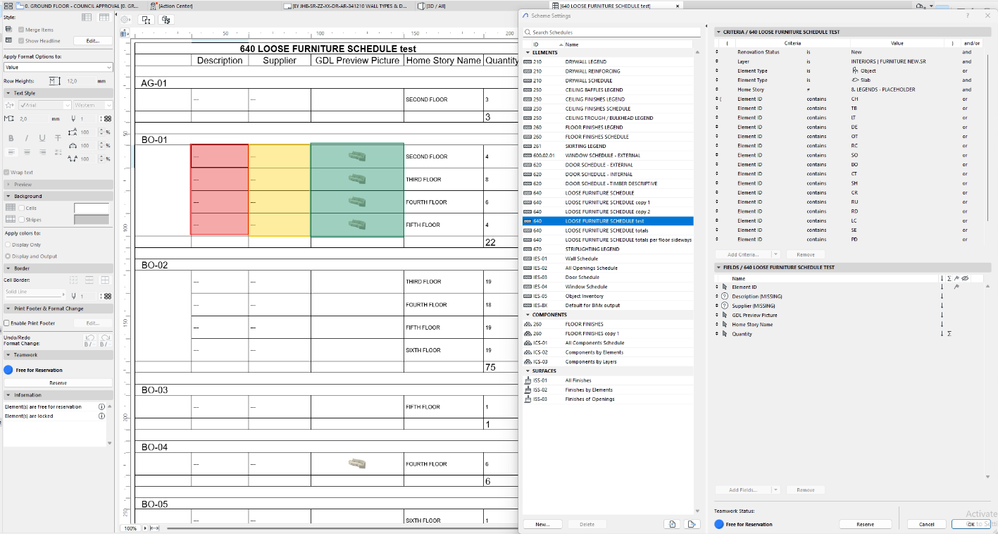

Hi Mathias.
I've been trying to get it to work, but I couldn't get it...
Here is my setup...
I assume I create one for each floor? And how does the expression work for each floor?
That option is greyed out...
