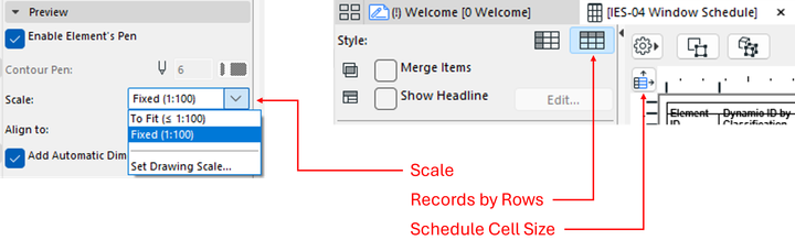

Hi all,
Maybe someone can point to something I have missed, given ACs documentation is so dismal, but is there a way to resize the rows of a Schedule when you use the Restructure Table option when placing on a Layout? I have a 5m window and having the elevation sub-row at a fixed height for every subsequent row when everything else is half the height is ridiculous...

Hi @Lingwisyer
Previews can be scaled To Fit or Fixed but diference between sizes will be shown anyway.
May be you could change the Style as Records by Rows instead of Records by Columns and then resize by columns and rows to fit content.

Scaling - Maybe if it would let you make an independent cell...
By Row - Makes the situation worse since now your previews are bound by the widest set of sliding doors, and the cell height issue is moved to the info boxes...

Was looking at this again, and thought that maybe I could duplicate the schedule to have an alternate row height, but it would seem that the Align to option is to some invisible bounding box, not the cell itself meaning that after shrinking the preview row, the "bottom" is now in the row below...
