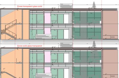

So zones in sections/elevations are solid blocks. If I want to see my project I must make a Graphic Override Combination to make them transparent. But I don't always want glass to be transparent.
Half baked solution.

If you create Surfaces to match the Zone Stamp colour and match these surfaces to each Zone stamp then everything works because these Surface can have transparency without a GO.

2021-11-09 11:44 PM
Zones in Section don't have to be solid and glass can be solid if required.

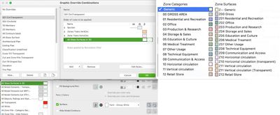

2021-11-10 12:17 AM - edited 2021-11-10 12:19 AM
What settings do you have applied to your zone surfaces to create the transparent zones and opaque glass?

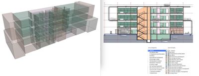

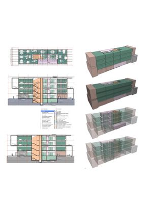

2021-11-10 12:58 AM
I have a series of Surfaces which match the Zone Category colours. I use them for both the Section and 3D views. These Surfaces are semi transparent and the Sections have transparency on. I have introduced an additional GO rule which changes the Glass Surface to white (to remove the transparency). I use the Zone surfaces as shown because I think its a waste of time to to just show Zones in 3D as Glass especially when creating a Massing Study.
