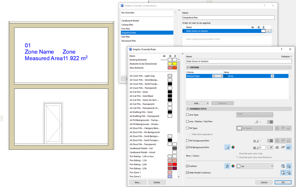

I experimented with this a little bit and I have found a Graphic Override Rule that will hide Zones completely in Sections/Elevations.
Apparently, you have to:
1. Override the Fill Background Pen of Cut Fills with Pen 0 (Transparent).
2. Override the Surface of Cut Surfaces with "Air" (fully transparent Surface).
3. Hide Model Contours of both Cut and Uncut elements.
Of course, this applies to Archicad 25 Update 2 and later as Zones are not displayed in Sections/Elevations in earlier versions.
I think this is as discussed earlier.
It only works if you have 'transparency' on in the section/elevation settings.
So if you also have windows, shower screens, glass cabinet doors, etc., that you don't want to be transparent, you then have to use a non-transparent glass material for all of those objects.
