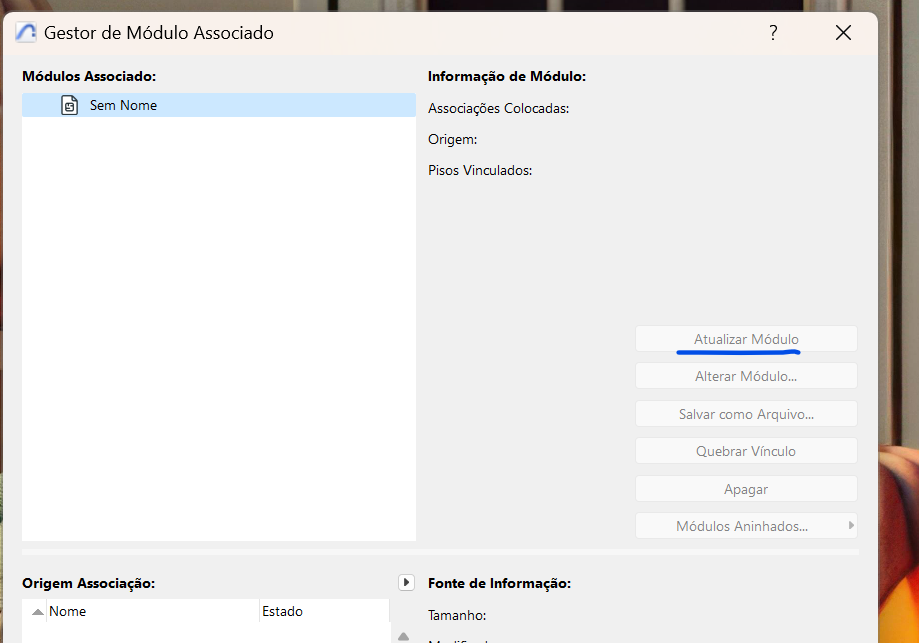

Gui Lima
You can activate a hidden function in registry editor to allow update hotlink modules separately.
Follow this:
1 - Open Registry Editor from start menu
2 - Locate this entry Computador\HKEY_CURRENT_USER\Software\GRAPHISOFT\ARCHICAD\ARCHICAD 24.0.0 BRA R1\Hotlink , this folder probaly little different.
3- Change the option in Hotlink Module Update to 1 and restart archicad
Now when you open hotlink module update you can see this button, to update only one module.
