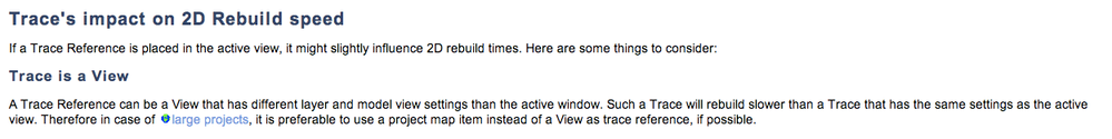

Stress Co_
and on the downside............. (from archicadwiki)
yeah, i knew this... I've been using trace ref in the same way ghost story used to be: ie, same layers as my active view and tracing story up or down or other story. However, I still find it infuriatingly slow in comparison to what ghost story used to be like.
I dare not use a different layer comb for the trace ... which in effect means that not only am I not using the amazing new capabilities this new function could offer, but I am not even using what I did use quite a lot prior to this 'improved' functionality.
