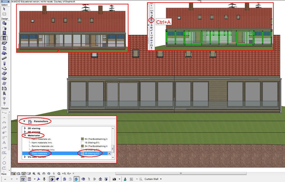

Hello Arcadia!
One way to solve your problem as I have understood it, is to avoid theTransparancy in Shading option and focus on the materials in your windows. As you can see under, I have made a ballustrade (or a glass raling) on the veranda/terrace on Grethes House . The ballustrade is made by the Wall tool with Glass as material.
Then I go to theWindow tool and click Ctrl+A (for Mac probably Apple + A ...) to select all windows. Then press Ctrl+T (Mac: Click on the Window icon... I think) to see the dialouge box. Change the material of the window from glass to something not transparent.
(Sorry for some of the language to be in Norwegian...):oops:
Then you will see through the ballustrade, but not the windows.
Good luck, Arcadia!

2009-09-03 12:54 PM
2009-09-03
12:54 PM
Thats a good idea - I will just have to remember to change the window glazing back to glass before I run the VBE export. Thanks.

2009-09-03 01:56 PM
2009-09-03
01:56 PM
I think another solution mentioned earlier on the Talk was to place those elements you want to see transparent in Elevation on a Layer set to Wire-frame mode.
