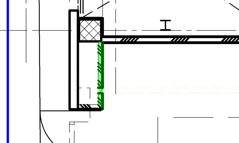

Layer/intersection priorities when concerned with walls:- is it meant to be of some sort of help when walls which are assigned to layers which are turned OFF still have an affect on walls that are turned ON?
We have a large project with all sorts of phasings, diagrams and GA drawings and this is driving me slighty insane. Can i suspend this (seemingly) ridiculous "feature"?

I would agree that for walls which are being displayed / turned on, this feature is imperitive, of course. But i can't figure out why walls which are turned off, need to affect layers which are turned on? It doesn't make sense to me.
Example attached;
("turned off" wall shown as trace)
undefined
I agree, elements on layers turned off should not effect any other - unless someone knows a skilful application.

there is an add-on which will resolve all your layer intersection priority problems, so you don't have to do it manually... download, install and use.
which add-on does that?
__archiben
it's called 'Intersection in Combos' . . .
