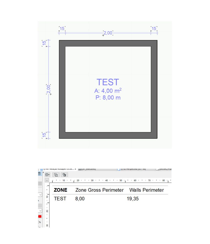

Walls Perimeter in a Zone Schedule bring wrong values. They are bigger than the Zone Perimeter itself.
Not real. Is it a bug?
PS. The value doesn`t match both sides of the wall either. See image attached.

I think you will find that the perimeter of a wall, is both sides and the ends of the wall as well.
Try it with a single wall.
The length of the wall in the inside face may be more of what you want, if you don't want the zone perimeter.
Inside/outside will depend on how you have placed the walls.

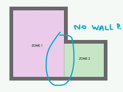

Thanks for your reply. But there is no such Zone's parameter as Lenght of the wall Inside/outside face for schedules.
Zone perimeter doesn`t attend me. See image below.
