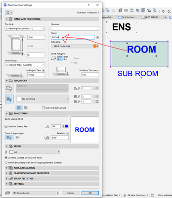

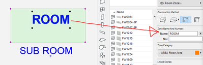

Where are you trying to view it.
I use them as Room Names, and the zone can generate information about floor areas and volumes of the room.
If you want to see it on your floor plans, you need to check the box in your model view options
And you can update the name in the zone selection settings.
Good Luck,
Chris
ArchiCAD 19 to 27
Windows 11
Chris Pooley
Hi Again,
Sorry, I should also say, you are correct, it is related to the Zone tool.
So you find this in the Design Tab > Architectural Tools > Zone
