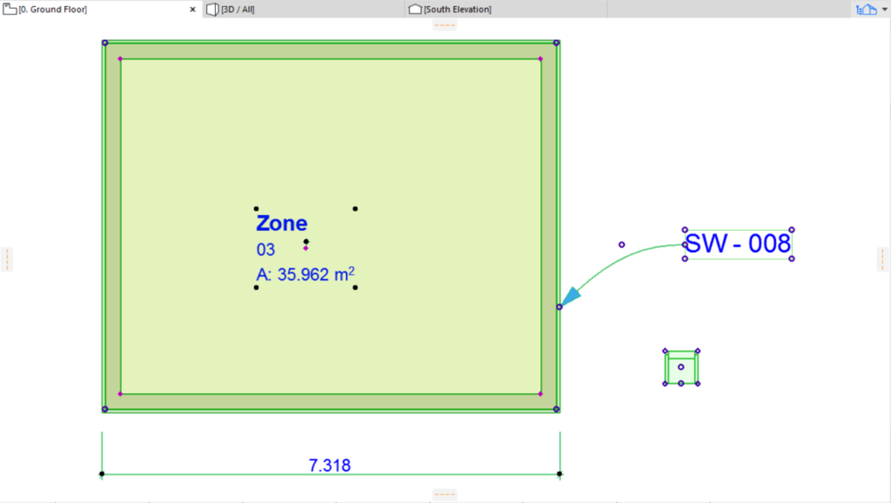

This is a simple example below to show how the elements of several types are organized into groups when they originate from the same Module.
Let's see the Module in a separate instance of ARCHICAD:
Only the four walls are organized into a group.
When this file is hotlinked as a module into the host file, all the elements are "grouped" together. (However, suspend groups command does not enable the editing of them.)

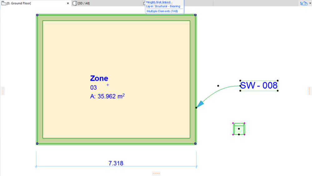

When you break the hotlink of the Module, Zones and Dimensions "fall out" of the group, while other elements (four walls and a label) stay part of it:
After ungrouping you can see the hierarchical structure of the group: there was a subgroup of the four walls in the group. This subgroup still stays a group:
